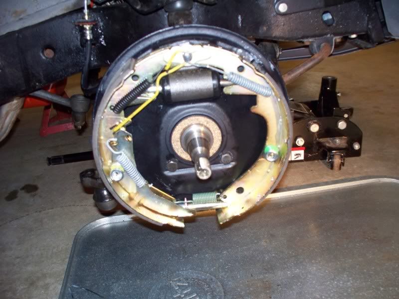

          • Kenneth S.
            • July 31, 1981
            • 302
            Re: 2nd Chapter_63 brake bleeding challenge
            Here is a picture of my '63 right front brake. Note the self adjusting lever is above the adjusting wheel where yours is below. I can't see in your picture, but do you have the little spring that holds the adjusting lever up?
            Ken

              • Harry S.
                • July 31, 2002
                • 5342
                Ken, yes, in that picture the spring was not installed yet. I knew it was missing when I took the picture. The lever went to the correct position above the star wheel after I put the spring in.
