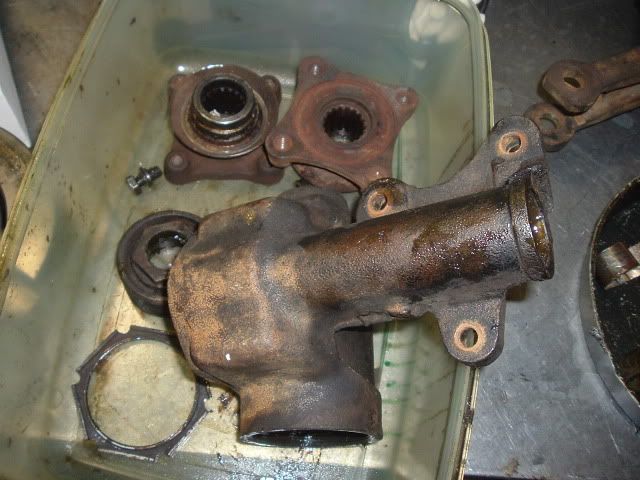

          Well fellows, I have done the 63-67's and some were painted and some were not. Now I can't say if they were worked on in the past either. I know some were and again others were not. I did a 63 Z06 box and was told to leave it bare iron. Blueprinted a box a few years ago and was told to leave the 40 year build up of dirt, grease, and oil on it. It was the best built dirtyest box I ever built. Now with that said, I just broke down a virgin 66 box. I know this because the internals were original. It does appear there may have been some black on it and the yellow ID was on the side as a large dot not a long line. As explained earlier the gears were shot. This will be blueprinted but also painted. The owner is more interested in the best box and have a solid coating on it.
          So I'm not saying anyone is right or wrong, just what I've seen.
          Here it is

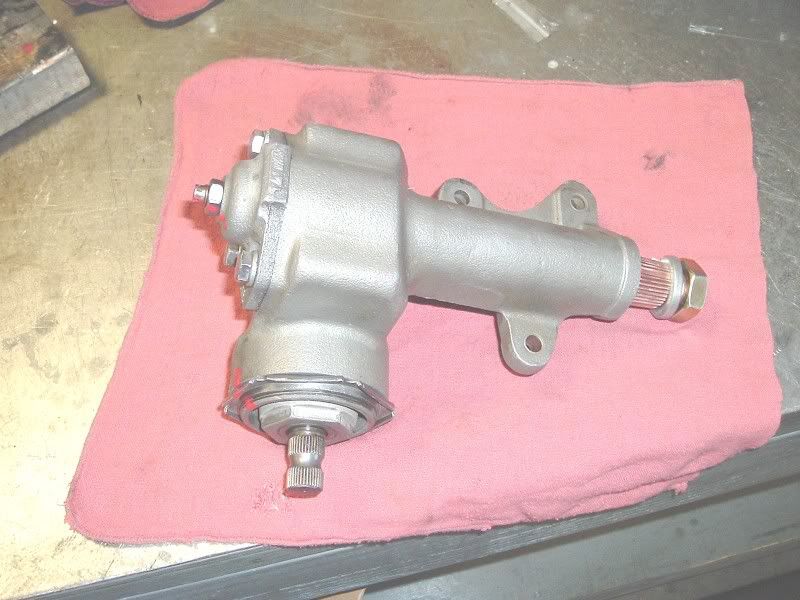

            For those unsure what the finished product looks like. These may help before you start to paint or finish your box.
            This is a blasted and brushed box, oiled only.

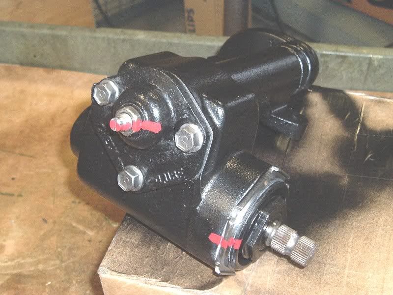

            Here is black box, the witness marks are to prevent an alingment shop from playing with the box. They can be removed easy enough. Notice no yellow marks, I leave that to the owner to duplicate.
            There were blasted, etched, POR15'd, and top coated.
            Hope it helps and saves you time on the finish question.
