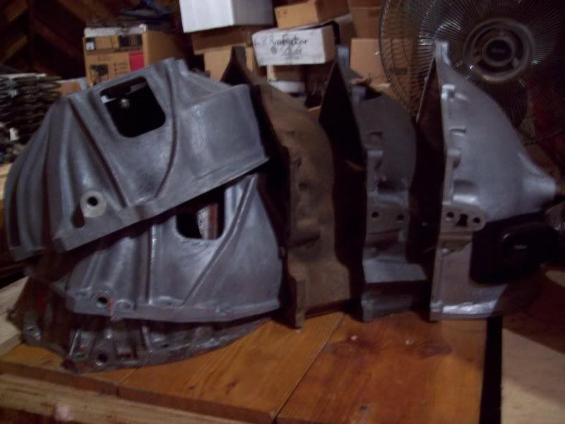

                  Ok, I rounded up a selection of bell housings and took a picture of the side where the boss is (or needs to be) for the clutch cross shaft bracket should be attached.
                  I'll identify what each is, but to keep it simple, it appears that ONLY open bottom (iron and alum) pass car housings have the necessary, correct boss with two threaded holes.
                  First, the housing on the lower left is the 64-later full enclosure, 403 style which only fits the smaller, 153 teeth flywheels and requires a block mounted starter with a straight across bolt pattern. It has a single hole, in the forward position only, at the same location of the forward hole of a pass car housing with the required two holes.
                  The second housing (on top of the 403 housing) is the larger, full enclosure, 66-later 621 style (as well as the 444 and 697 style) that is used with a big, 168 teeth flywheel and requires a starter with a CAST IRON, staggered bolt pattern nose.
                  The housing on top of the 621 style is the early-70s-later full enclosure truck housing (notice the additional bulge on the lower part of the housing). It has the boss on the side, same as the boss on the pass car housing, but with only the rear hole. I'm sure a forward hole could be drilled and tapped.
                  The (rusty) housing in the center is the mid-50s thru early 70s style truck housing. It has NO BOSS at all, thus, it won't work if a boss is required for attachment of a bracket.
                  The housing next to the far right is the 55-62 style iron housing used on pass cars (-59 on Vettes). As can be seen, it is the only housing with the required boss with holes for attachment of the bracket.
                  The housing on the far right is the 61-62 alum housing, with a boss, which was used on 61-63 348-409 pass cars and ALL 61-62 Vettes.
                  There was NO 168 teeth flywheel/large housing used on ANY 63-65 Vettes (including the 65 396 Vettes).
                  This is the BIG, full enclosure bell housing used ONLY on 64-65 pass cars (full size pass cars with BB and Z16 65 Chevelles). As can be seen, it's a considerably different housing----------------RARE/EXPENSIVE!
                  As you see, it has the same type of single hole boss as the later full enclosure car housings.
