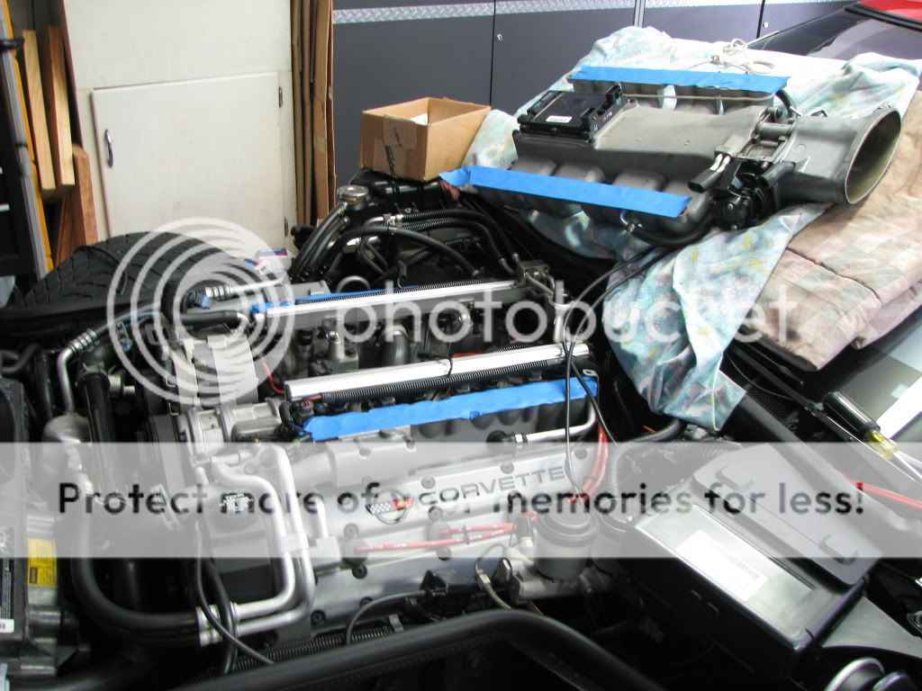

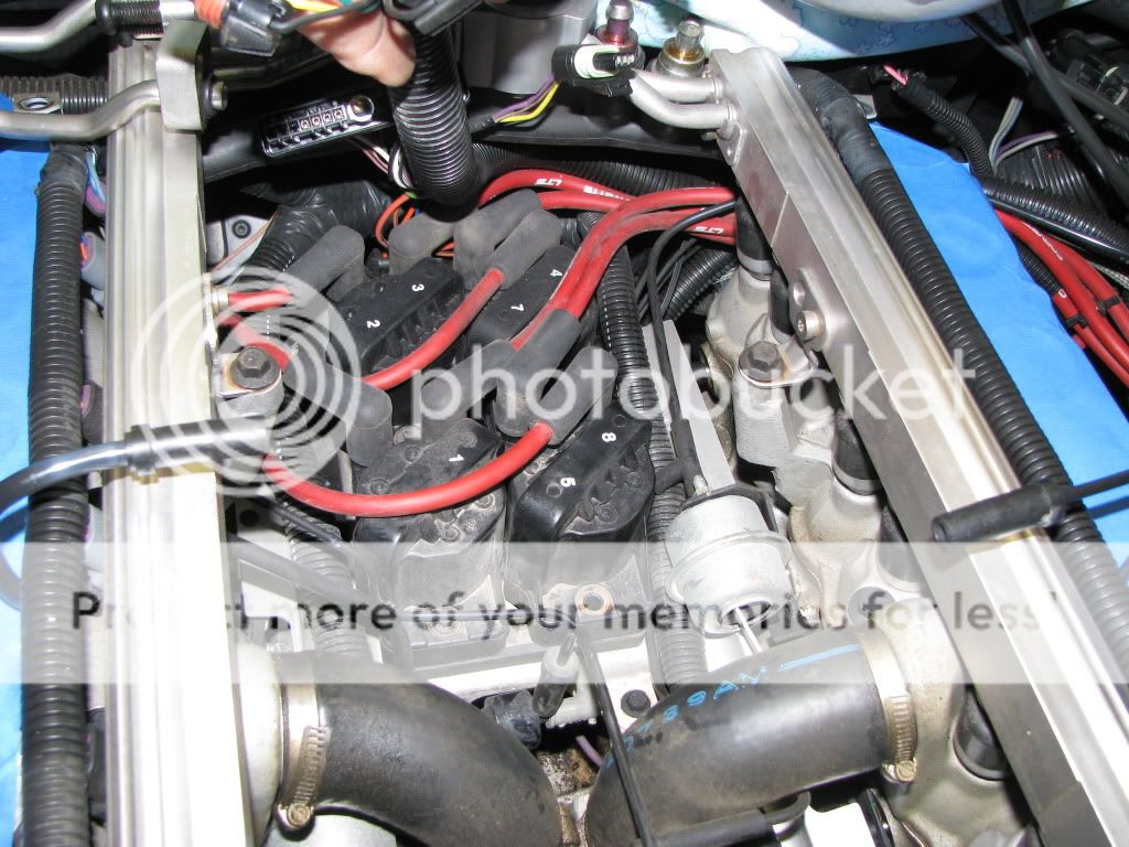

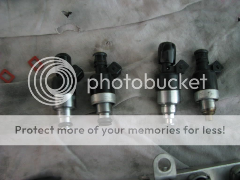

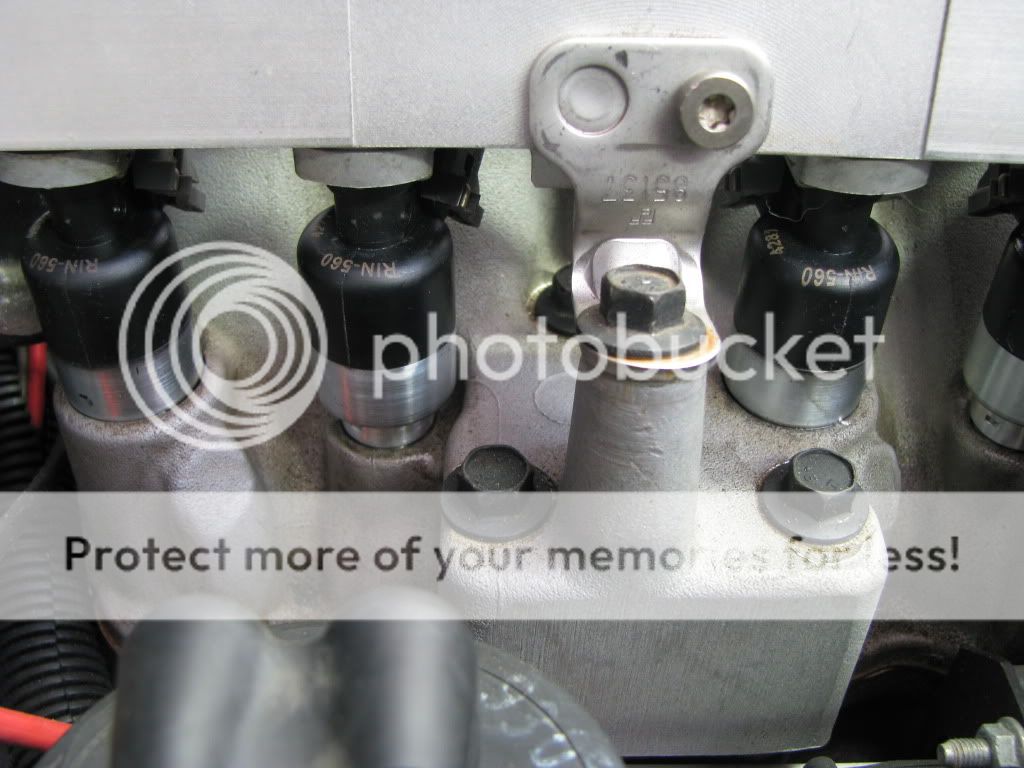

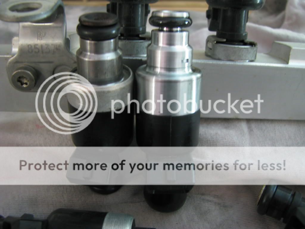

    I have been working with Jon Banner (Fuel Injection Connection) to get a set of ethanol-resistant fuel injectors that have original appearance and function. Attached are a couple pictures of what I have installed in my 1990 ZR-1. These are 1995 Delphi injectors that have been modified to fit the Z. The part number, of course, is not correct, but everything else is. The car runs perfect.
    Store your photos and videos online with secure storage from Photobucket. Available on iOS, Android and desktop. Securely backup your memories and sign up today!
    Some of you may not know it, but the early multi-port injectors were wet-coil injectors, which means that the gasoline is in direct contact with the injector coils. The ethanol in newer fuels deteriorates the insulation on the injectors (mine made it to about 12,000 miles) at which time they begin to short out. Initially, the car actually seems to run a bit better, because the injector tends to stay open a bit longer. It first shows up during emissions testing. As the injectors deteriorate they stay open way too long and short completely out, causing them to quit. At this point the inectors put such a draw on the coil packs that they can short out as well, usually after the car has been run a while. Later, the coil just fails completely.
    Putting the old-style Multeck injectors that are going to fail again did not make sense to me, although I can now pull, reassemble, start, pull, reassemble, and start in less than 4 hours, as I had a new GM 545 coil crap the bed on me, which was found after the first reassembly. If anyone is interested in these you can either PM me or just go to the FIC site, fuelinjection connection.com. If you call (numbers on the website) ask for Jon and tell him you want the same injectors sold to Jim White. I hope this helps some of you out, and no, there's no kickbacks. It has just taken me several sets of injectors and much pain to get this far.
    Jim

      Joe,
      What you're saying is true. As a matter of fact, my 90 ZR-1 Owner's manual specifically says it can use ethanol up to 10% --- GM lied. This has been a topic of discussion on the ZR1netregistry.com and nearly every owner has had failed injectors due to ethanol in the gas. When GM was approached about this a few years ago their response was that the cars were designed to run on the fuel availble at the time and they were not going to make any adjustments. Interpretation --- we're not selling those any more so we don't really care. If you were to put new GM Multec injectors in a early C4 you'd find they are extremely expensive, not ethanol resistant and will begin to fail in 12,000 to 20,000 miles. Not much of a deal. The part numbers don't reflect a real change either, as GM often goes to a service replacement part that fits several model years after production. There's quite a bit of information in the various ZR-1 forums and C4 forums, as well as websites that deal specifically with the ZR-1, although my understanding is that the injectors were not ZR-1 specific.
      ANyways, that's what I did and why I did it. Not saying I'm the sharpest knife in the drawer, just trying to get by.
      Jim

                I used myself as the guinea pig, as Jon never gave it much thought. We discussed what I needed for NCRS judging and he tried a couple options, the first of which did not work out well. It could have been a bit of trash in my fuel rail that got lodged in the Standard-brand injectors he made up for me the first go-round and caused an injector leak. However, he investigated other types of GM injectors that would have the correct appearance and function and this is what he came up with. Now that he understands what NCRSers need, I think you'll find he can make up suitable injectors for most any car. Like I said, mine are 95 Caddys. BTW, he not only ate the cost of the original injectors, but didn't charge me for express shipping, machine work or any type of return fee, even though the fault could have been mine.
                Jim
