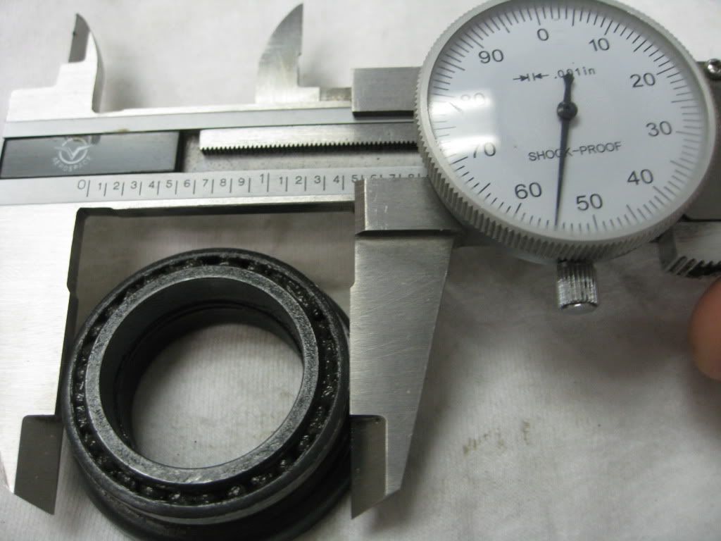

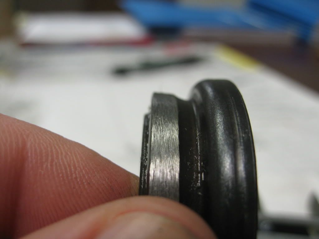

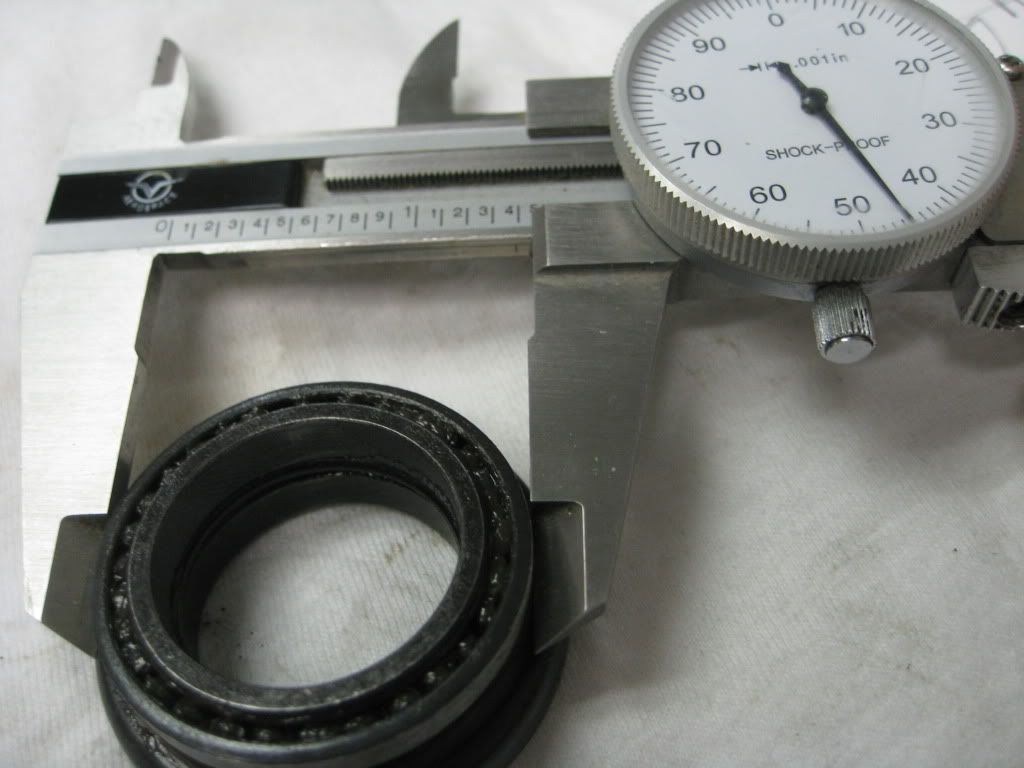

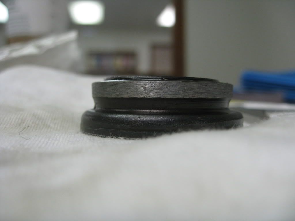

    OK...The OD of the bearing that should be an interference fit to the mast is machined with a 0.010" taper, with the big end going in first (1.455"). There is no lead-in or chamfer to help, either. Just a sharp corner. Even if I could get this over the shaft all the way to the mast, there is no way I could get it seated.
    The ID is OOR 0.003", measuring 1.007"-1.010". What is the spec for the OD of the lower steering shaft? Mine measures 1.009" at it's largest... There is no way the bearing can slide over the shaft as it is.
