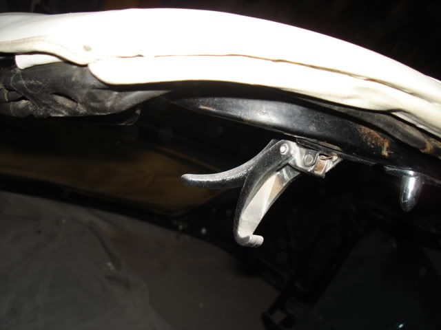

                      I got so frustrated with that front windlace in doing my top about 3 years ago, I finally resorted to making my own.
                      With all due respect to Al Knoch, the top kit I had wasn't his, but an older Zip top from the 90's which had a windlace with the blunt ends, was oversize, and was so old the foam inside had cracked. I got a new one from CC, same thing blunt ends, and humongous.
                      So I went looking for the right crushed gran material to make my own. Nada, could not find that material. So I got some matching top material and made my own with upholstery foam rubber beading:
                      Even hand sewed it:
                      I did this twice, first with 3/8" upholstery bead. The corners came out just right, but the windlace wouldn't seal to the top of the windshield frame:
                      So I took this one off and made another with 1/2" upholstery bead. That one sealed but the corners just didn't fit just right. But that is how I left it.
                      If I could find the right material, I think I would do it again, maybe with the 3/8" bead wrapped in some lighter fabric.
                      Another trick I learned after the fact is that with 1/2" beading, one could taper the beading at the ends where it tucks into the notch at the corners.
                      Might try that next time.
                      Frustrating, but it's all fun.
                      Jerry Fuccillo
