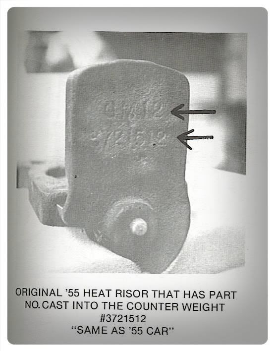

    Anyone...
    "55" 265cu. V8 Late/Early Build Date
    What is the correct shape of the weight on the heat riser?
    Tombstone or rectangler style?
    Was late build date different than early?
    Passenger different than Vette?
    Karl.

    Re: Correct Heat Riser for 265cu. V8 "55"
    Originally posted by Karl Litzner (1264)
    Anyone...
    Tombstone or rectangler style? YES
    Was late build date different than early?NO
    Passenger different than Vette? NO
    Karl.
    This is the design for all 55's in 56 it changed and 55 car used the same design , there being repro'ed but are easy to tell from original .
      Thanks Roy,
      I bought a used one last year on ebay. (Tombstone)
      I think I have three of the rectangular ones I"ve gotten thru the years.
      Know I know for sure.
      I had thought, maybe the late "55's" used the latter heat riser.
      Karl.
