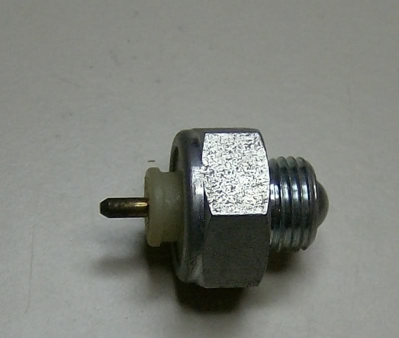

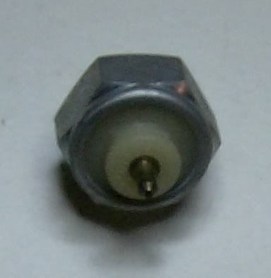

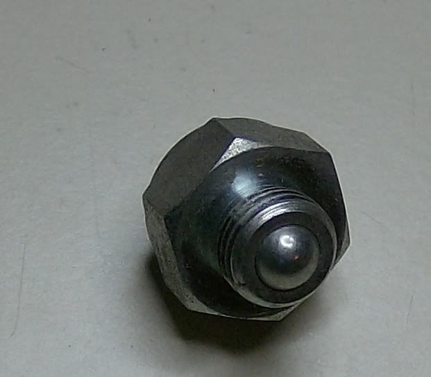

              • Dennis D.
                • March 1, 2000
                • 1071
                Re: 70 SB TCS 4-Speed Trans. Switch
                Think this is the original
