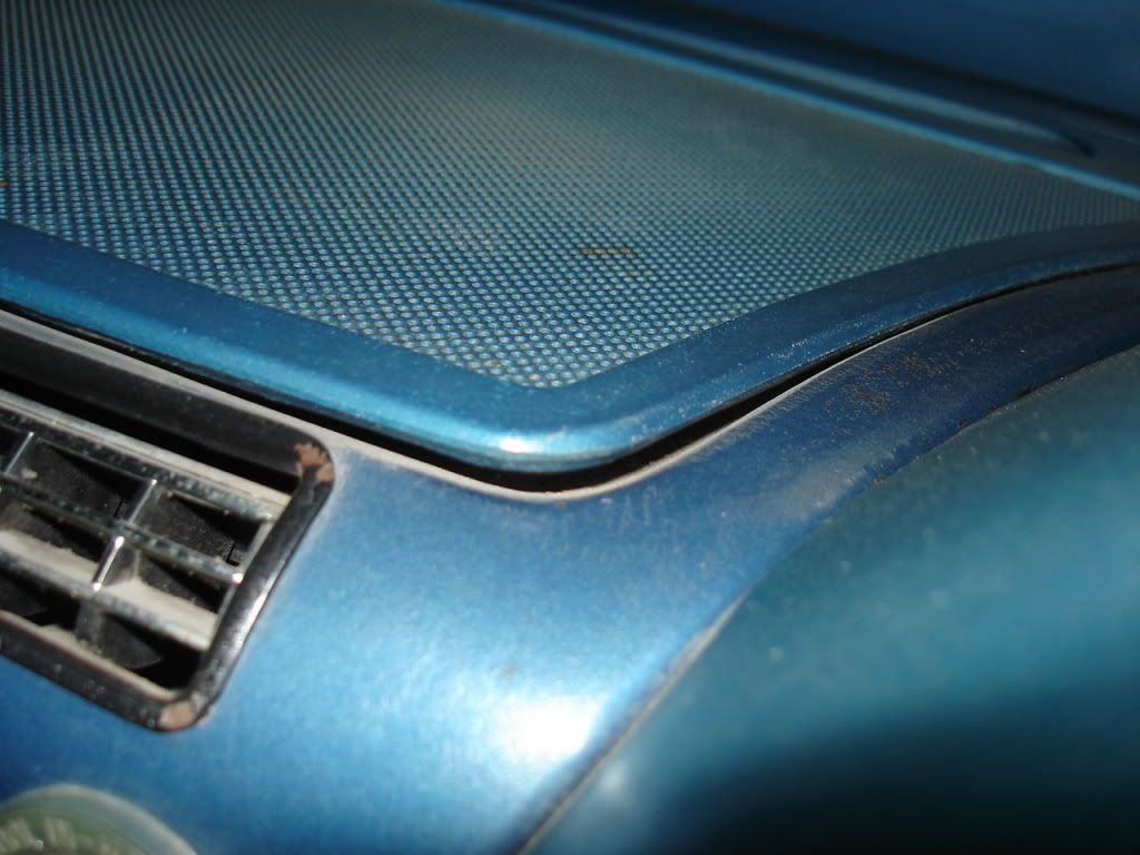

              • Wayne W.
                • April 30, 1982
                • 3605
                Re: 1967 blue interior
                I think the two bright blues with 3 and 60 % gloss are essentially the same color, but the dark bright blue is a different color. Certainly there are several different shades of blue in a 67 bright blue interior. It appears that the dark bright blue is the color that is used on those dash parts that are subject to glare. Unfortunately it is difficult to get a true representation of the blue color. It just don't translate to this screen very well. Here are a couple that are pretty good. Note that the dash pad itself has a more greenish tint.
