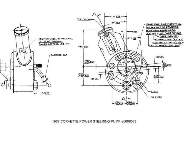

      The following scan is a 1967 Corvette P-pump #5698078. Note that the test date code location is called out the same as your pump. Your coding would appear to indicate January 21, B-shift, 1966. However, there seems to be some additional coding in terms of assembly station (L or R) that was omitted.
      Note that there is also a alpha sticker "AG" on the fill neck for the 1967 pump. I don't know if the 1966 pump had an alpha sticker or what the letters were.
      One other thing: The cap that is shown on the pump is plastic and is called out as 7803820. The drawing was updated with a different cap as revision Z on 4-8-68. The original cap was 5690846. So the original cap may have looked different (metal rather than plastic?) than the one shown.
      If someone could supply the part numbers for the 1963, 64, 65, and 66 pumps, I will try and obtain the original drawings.
      One last thing: Saginaw was very good at updating their service parts to reflect the latest designs (as long as they didn't affect serviceability.) So usually there is a revision trail in the revision boxes on the side or bottom of the assembly drawing. The real killer is when a drawing is "revised and redrawn". Then the revision trail is archived up to that point. Finding those prior archived drawings with the revision trail is becoming very difficult.

        Very interesting drawing!
        I am suprised that The Judging Guide does not mention the date code, even if it is tough to see .That is why I posted the picture. I fiqured others were probably not aware of it either . It appears however from that drawing that they all have one though.
        I am sure Joe Lucia will be able to give you the part #s for the years you requested. He might also know if and when they quit stamping them.

          I know there was mention of the date code in the 1970-72 TIM&JG at one time -- it might still be there. Unfortunately we didn't know exactly where the date was. The parts book made reference to a date code, and that was the reason for the mention in the 1970-72 manual.

            The 63-69 power steering pump part numbers were as follows:
            1963------GM #5691158 (also early 1964)
            1964-------GM #5692842
            1965-------GM #5693140 (all except L-79, L-78); GM #5696222 (L-79); GM #5696999 (L-78)
            1966-------GM #5696222 (all except L-36, L-72); GM #5696999 (L-36, L-72)
            1967-------GM #5698078
            1968-------GM #5698078
            1969-------GM #5698078 (early); GM #7808286 (late)
            The GM #5690846 reservoir cap was metal. This cap has a "smooth" perimeter. The GM #7803820 cap was mostly plastic. This is the cap with the "serrated" perimeter. According to GM it was introduced sometime in the 1969 model year. However, I suppose it might have been introduced prior to that.

                    Saginaw manufactured some of their pump reservoirs and purchased others. That coding on the back side of the reservoir could have indicated the source or some internal manufacturing date.
