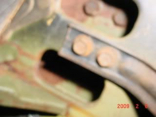

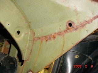

                            • Keith L.
                              • April 7, 2008
                              • 378
                              Re: Bird cage color?
                              My A22 70 is green where yours appears black.
