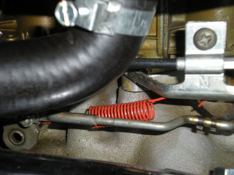

        68 400 hsp.
        Jack Corso

          Originally posted by Jack Corso (21713)
          68 400 hsp.
          Wow. I'm not really as familiar with C3 435s (mine is a 67 435), but did GM really hang the return spring on the fuel line?

            I believe this is true. Early 68
              No, there should be a spring that extends rearward from the throttle shaft to a small hole in the cable bracket.

                The short yellow spring, MAY have been on later 68's in addition to the main spring. The orange was on 69's per the TGJM. The main spring is correct on the 68.

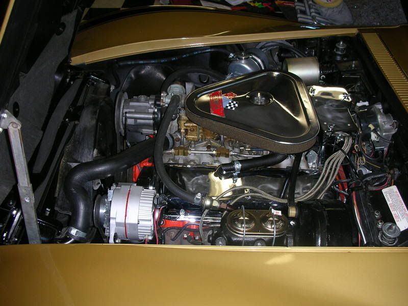

                      Jay, It was part of the lever on the center carb throttle shaft. It was hitting the valve cover. My original dated 69 center carb did not have it. I'll get a photo tonight and post tomorrow.

                          The first picture is of a correct 69 L71 carb with the lever attached. The second is a 427 400 with the service carb with the piece of the lever that was hitting cut off.
                          John
