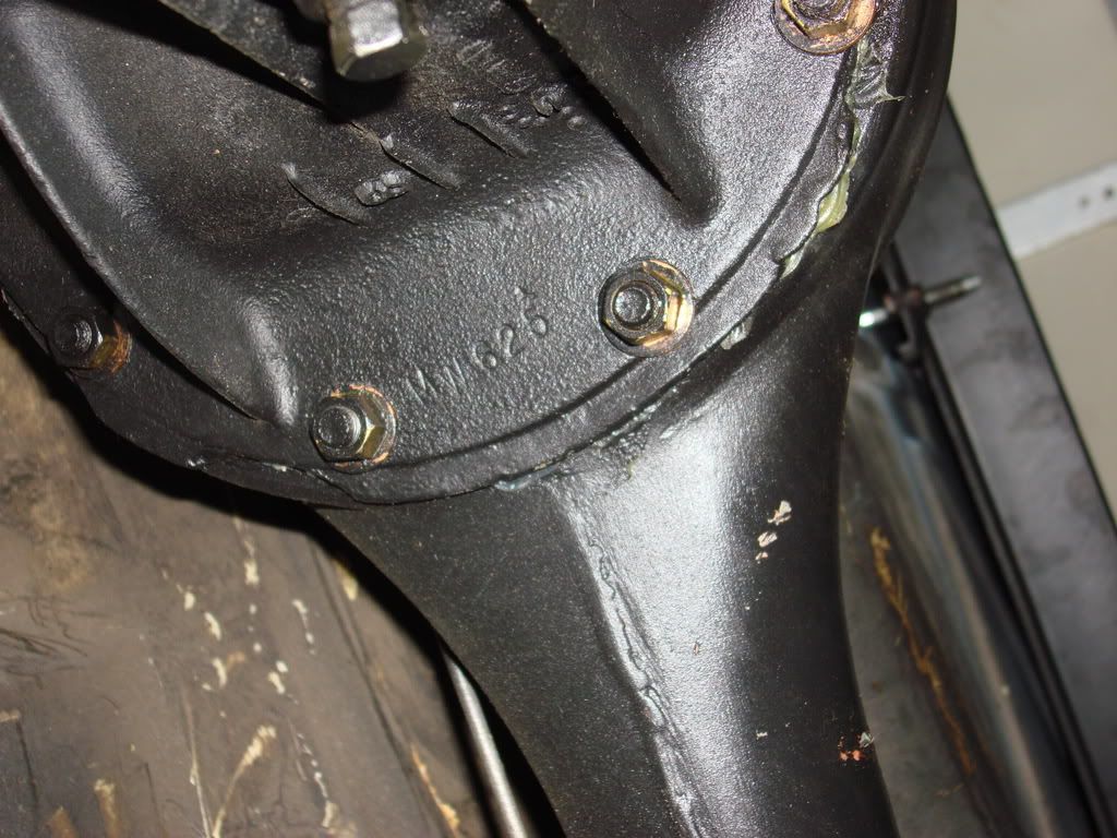

    Can anyone interept the codes on this C1 differential? It appears that it is for a 55 6 cylinder with powerglide.
    http://i233.photobucket.com/albums/e...0zr1/MW625.jpg
    http://i233.photobucket.com/albums/e...r1/3698950.jpg

    There is no 6 or 8 engine rear gear differences ,53 to 55 were all the same gearing

      Fenwick, the MW 625 is the date code. Yours was made june 25, 1954, and is for a 6 cylinder. The part number is correct for a 6 cylinder 54 or 55, but most likely from a late 54.
      Joe

        Thanks for the information. It looks like it's for a 54 car.
