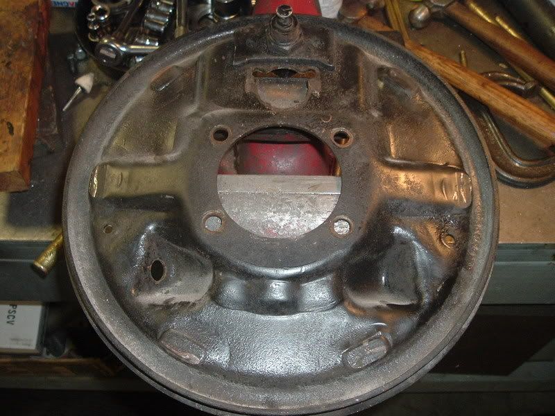

    Here is a LH plate from a 63 Fuelie I did the bearings/arms on. The holes were fine no issues, maybe you can compare it to yours.

      I did not take pictures but did remove the nuts and split washers. Bottom line, the holes were somewhat oval in shape, bigger than what you are showing here, and had scrape marks under the split washers which indicates to me that rotation was probably taking place.
