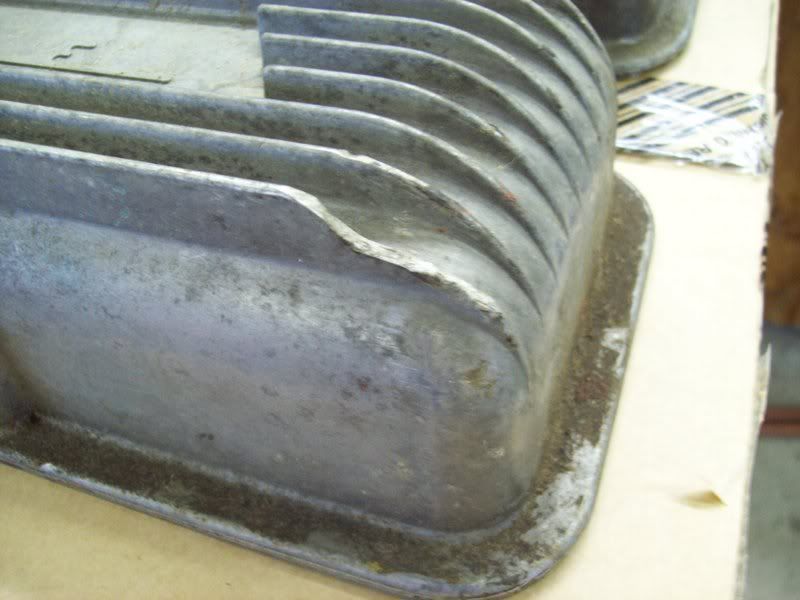

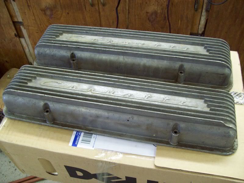

    Just VERY recently, I acquired this pair which will need welding (I've already taken it to a friend who does excellent, precise alum welding) and then grinding, shaping and finishing. A couple of fins have small nicks and one fin has a chunk missing that will need to be built up. It's not really a difficult thing to do, just takes time.
    When finished, these are going on the 1966 2.02 heads on my 56.
