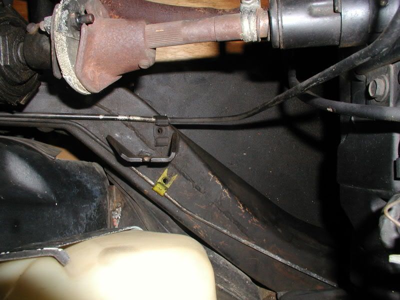

    Hi all,
    As usual I turn to most experienced group of folks on the planet. My question is regarding the brake master cylinder outlet line and if it is held in place by a frame clip or not? The is a old broken clip beneath my line and it would seem normal if it was but no mention in the JG. Any help is appreciated.
    Craig W.

    Re: 1964 Master Cylinder Outline Line ?
    Craig:
    This is how our '64 line is clipped to the frame - I'm not certain this is completely original, but wanted to offer the photo in case it helps.
