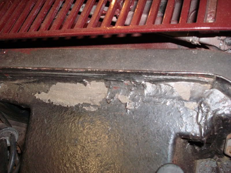

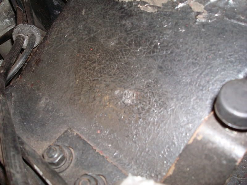

      ok guys here are 2 pics, one shows how the area is bare and the other shows the indention that I need to build up a tad. Whatcha think?
      see what I mean about bare? if I paint it now that area will lack the mat strand fiberglass LOOK.
      thanks

        Isn't that an area that is factory skimmed with some sealer ? Usually a pretty crudely finished area. Looks normal to me unless I'm missing something.
          It is normal. His picture is showing a typical fiberglass bonding joint, which won't have the usual fiberglass texture.
          The straight line on the right side of the picture is the top edge of the fiberglass panel that forms the pedal mounting well on the firewall. If that low spot above the straight line, or panel edge, is the depression you want to fill, forget about it...it's genuine Corvette. I believe the smooth area is actually the bonding adhesive where it was "tooled" or smoothed along the joint.
          Do nothing but scrape the peeling paint edges to remove all loose material. Some gentle sanding of the paint edges to feather the coating can be done if desireable, but if not required, simply refinish the firewall in a satin or semiflat black paint. Semigloss is a little too shiny in my opinion.
          P.S. The gloss of the black used on C3 firewalls varied widely. On second look at the pictures, I would say that the existing paint IS close to semigloss. If your engine compartment has never been repainted or detailed (often hard to tell), you may want to use semigloss black. I doubt you will lose judging points for any finish between semiflat and semigloss.

            All press molded panels. No need to change surface.

              Tom, Chuck, and Stan have given you sound advice. Your attempts will most likely yield the impression of a repair leading people to believe damage had been present at one time. Not good.

                thanks guys! I just assumed it was supposed to be mat strand there.
                well this is good news..if it came that way thats the way I want to keep it. I sprayed a little semi gloss on a spot around the area of the indention place thats why it looks shiny there so I'll go with a semi flat.
                I appreciate it! I think I'll even forget about that little indention place..not a biggie really.
