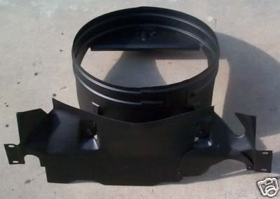

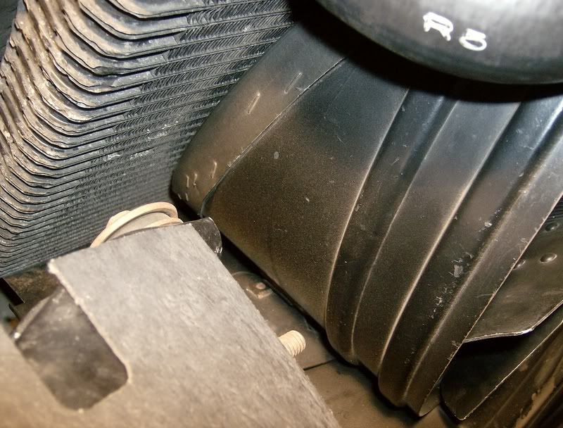

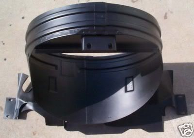

                I assume you mean the aluminum rad. Here's a pic of the driver side and the metal shroud. Posted this for someone looking for the nice factory staples on the rubber shroud seal . The rad number is on the top of the rad on that side. (3155316)
                You can see the number here just left of the stamp (borrowed from Dewitts)
                Bonus pics of steel shroud and lower baffle
