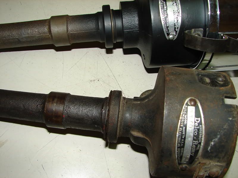

            • Roy B.
              • February 1, 1975
              • 7044
              Re: 1955 distributor
              55 dint use a dual point ever but there were two different design housings , top pic is first and bottom second design , second design came in around #400?
              Both used the same part number and most first design's had a date code of 1954
