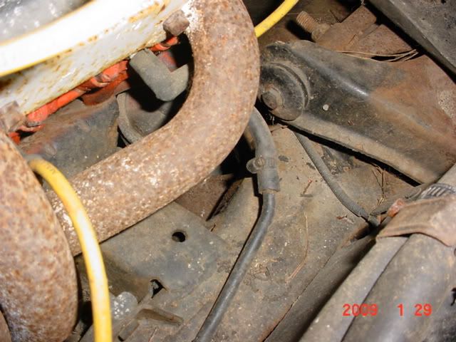

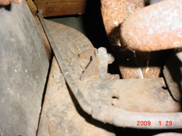

                      Re: LT-1 Tank to Pump Fuel Pipe
                      This is a Jan built 70.
                      • Harmon C.
                        • August 31, 1994
                        • 3228
                        Kieth
                        That picture is the same as one other that I have and I see why the vendors only sell one line for all. I will see if the standard line can be installed to look like your picture.
                        Lyle
