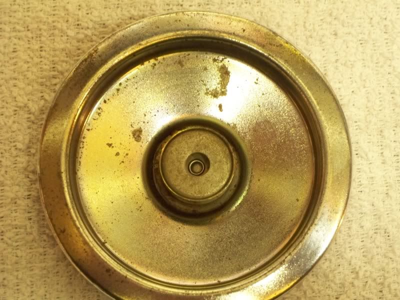

                    Re: Help to ID C2 gas cap
                    Here's a closeup of the bottom of an early '63 gas cap. Joe Lucia already mentioned the 'give away' of the presence of a crimp ring around the vent hole indicating '63L and up versions of the vented gas cap....

                        Jack,
                        Thanks for that picture of the cap, I don't believe I have seen one before, now to find one for my car.

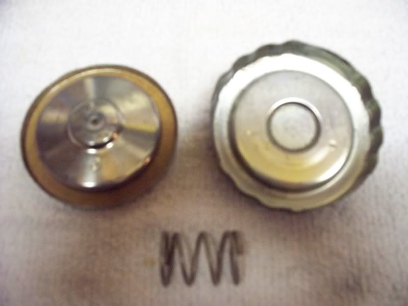

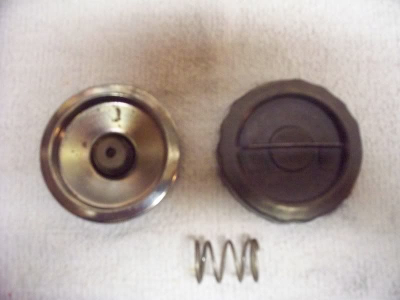

                          I have mine apart as I will be replating the cap. Since I'm not the original owner of the car it may or may not be original to an April 20th car.
                          This must be the 63L version. The one way spring loaded valve, allows air into the gas tank. The larger spring is there to force a good seal between the cap and the tank.
                              Stu, I've done a pressure test on that valve and it only lets air go in one direction, into the tank. I imagine this is to allow air to take the place of the gas as it used. It does not allow excess pressure in the tank out.
