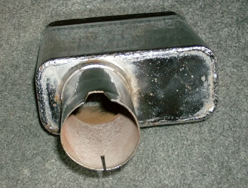

                      Re: Fortier First Design Tips Update Pics
                      A photo of an NOS 2nd design tip of the weld on the rear plate:
                        Here are photos of a first and second design tip.
                          Looking good! Agree about the weld. Pic of a 1st design weld if it helps. Similar to Dave's
                            Here's my first design tip welds:
