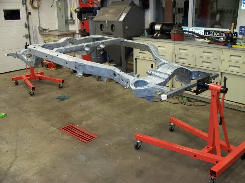

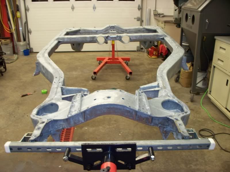

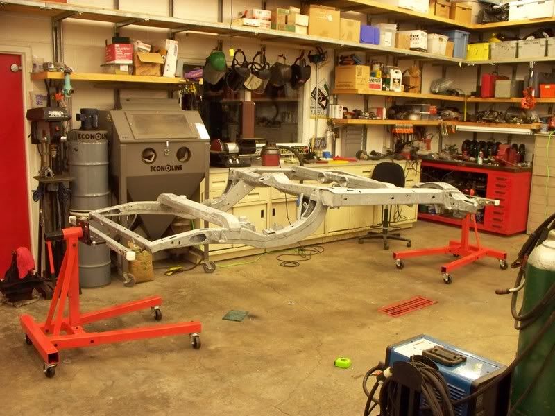

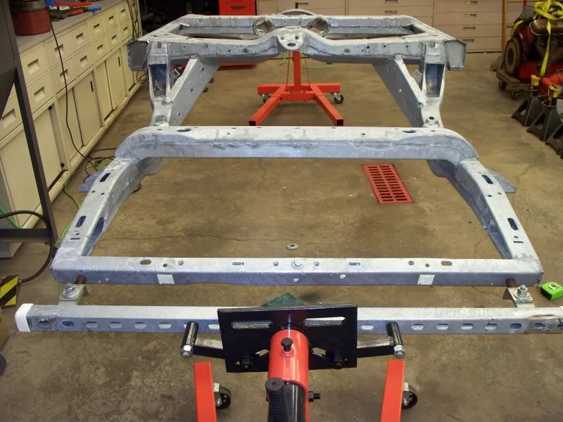

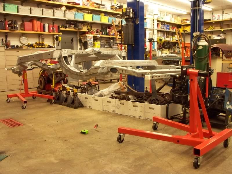

                  Here are some pictures of the Galvanized frame today. I have alot of detail work to do around all the edges but it will be worth it. The PPG Rep stopped at the house today to look at the frame. He is going to supply the Acid Etching Primer as well as all the other paints Im going to use.

                    Re: 1969 Frame Finishes
                    Ned,
                    Make sure the primer is black. No matter what the final finish is, if you drive it it will chip, and if the primer isn't black the chip will contrast with the paint and look very obvious. I learned this the hard way.

                          Off topic. I love your garage!!!! How big is your garage? I like the style of storage desk you have. Where did you get them.
                          I only have a 24x24 garage, 2 cars being restored. Center isle is shelving. No room anywhere. My sand blaster outside....under snow!! Basement is full of filing cabinets and car parts every where. I think I need a 48x48 garage to put stuff properly away.
                          Anyways if my wife sees how neat your garage is she'll want to park her SUV in there to get out of the cold..LOL

                            Sorry Grant...No SUVs allowed, they can be replaced !! I say they stay outside. The garage you see is 30'x50' and then I added a 13'x50' "clean room" on the back , and then a 17'x58' gameroom to that. Hey I have to have somewhere to play right? The cabinets you see came from some bank buildings Ive worked on. They remodel the places and were going to throw it all away. I just didnt have the heart to pitch it. Ive accumulated quite a bit over the years. Look for some commercial remopdeling jobs in your area and ask around. Im going to try a sample from the PPG Rep and see how it looks then decide what to use. Ill let you know how it goes.
