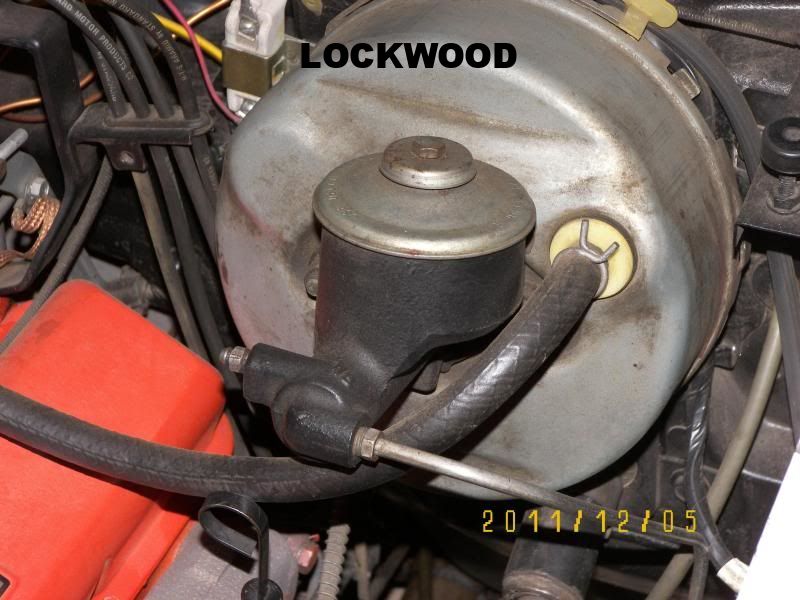

            • Jim L.
              • September 30, 1979
              • 1817
              Re: 1963 master cylinder
              Originally posted by Gerald Coia (11656)
              Also Tim, My car is an October car so your question of the thumbscrew or the hex head is important to me. Did you ever get an answer?
              Original master cylinder and booster on my '63, #3493:
              • Edward J.
                • September 15, 2008
                • 6960
                Jim was there more than one part number for boosters in 63? the no 3493 is that stamped on the booster? I know the judging manual calls out for No. 2574
                • Jim L.
                  • 1817
                  Sorry for not being more clear. 3493 is my car's VIN.
                  Jim
