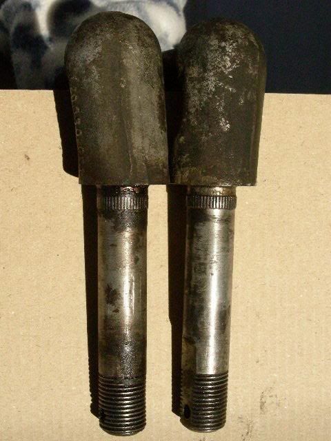

              • Dan P.
                • April 30, 2001
                • 139
                Re: C3 w/F41: Strut rods
                Here's a photo that illustrates the difference. The HD unit is on the left. Note how the "elbow" is beefier. Also note the cast part number on the side.

                  • 43277
                  Originally posted by Lyndon Sharpton (12791)
                  Joe
                  Is their anyway you could post some NOS examples of each mount side by side for a comparison?
                  ________
                  Kelly
                  Kelly------
                  Here are some photos I made quite some time ago:
