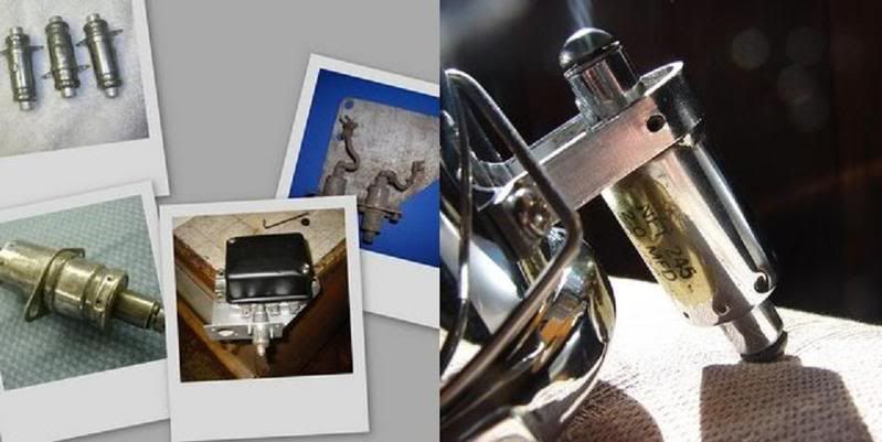

    What is the correct way to get the capacitor labeled back to original. Are they decals or does someone offer a restamp service?

    I don't know who makes them !But top left are the "one" used on the shielding.
    Bottom left is the two used at the VR.
    Right is the one used for 55 on the coil cover

      Someone makes the decals, Benjamin. They're really not decals, they're "stick-ons". I'd check the "usual suspects".
      I'm having a "senior moment" right now, and can't remember for sure, but seems I remember that John Clayton who used to have a 53 is the guy that made them years ago.

        I've seen the sticky decals but still wonder if some didn't have an ink stamp instead. You can see a decal starting to turn yellow in Roy's photo and I found a similar decal on one once.
        But the one in Noland's book appears to have an ink stamp. So I had a stamp like that made. If anyone wants theirs stamped I'll do it for $10 for all 3 (mostly gas to get to the post office). You just pay the shipping both ways.
          Your right , only the 55 coil chrome one had a sticker , the others a stamp as far as I know.!.
