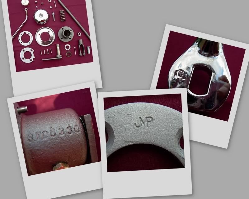

    Had some one ask about the shifter for sale on e-bay and how to tell if it's a repro, he wonted the real thing.
    This is how ,repro don't have the part number or logo's that the real original has.Also missing the indicator ring a separate piece. (bottom left corner JMP)

    Great Explanation Roy. Thanks for sharing that.

      I like helping people from getting ripped off by some sellers as so many people do.Thanks

        What keeps the grease in this thing? There's a grease fitting but it doesn't seem to have a seal of any sort.

          Right it's to lube the shaft and din't need a seal
