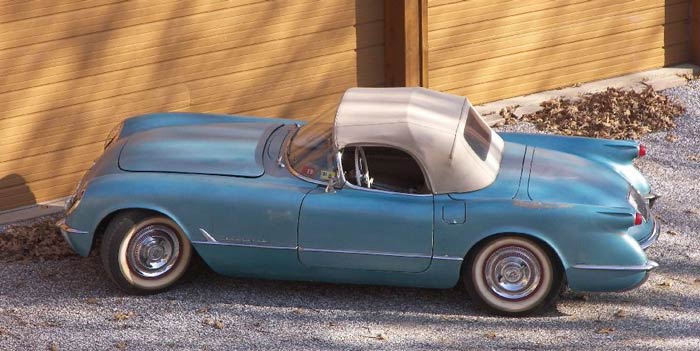

          • Russ U.
            • April 1, 2004
            • 345
            Re: 1954 Pennant Blue originality
            I have a bunch of pics of an unrestored original pennant blue car (#3300) on my website: 54 Blue Car
            53 to 55 cars have been known to change colors, so you need to be very careful.
            Russ
