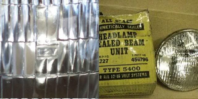

      The early 55's may have been riveted ,that can be judged and determined by checking at the valve stem they will have a tube.
      Mine is welded being a later second design that can be judged and determined again by checking at the valve stem NO TUBE .
      But now like the head light bulbs page 29 where they say the 55 had 12V (TIN BACKS "ALL" ) and again don't mention the later second design SEAL BEAM 12V that is all sealed Glass but still having the 12V logo in the bulb. Here again that can be determined by looking at the outer edge , TIN backs will have a black seal all around the glass and the second design being all glass will not.
      I've made mention of this for many years but that's as fare as it got.

          Here is some that knows his headlights for Corvette and car

            Great History Roy.
            Didn't know about the "tin back" headlights.
            Spent much of my youth (60s) in junk(salvage) yards looking for parts.
            Thanks.

              Thanks for your interest , here is the tin back (left) and the later glass second design seal beam.

                I recently sold a 12V steel backed bulb to a 55 owner. This one was used. I previously had one NOS that came in a NOS 55 Chevy headlight bucket, complete with chrome bezel. Those are the only two I've ever found in years of looking. I've never looked for the glass one Roy shows.

                  It is vary rare to find the 12V tin backs but near impossible to find the glass 12V because the tin backs can be rebuilt , the glass units when blown cant be. Tri-five Chevy guys are looking for both because they know about them for their judging. As I've said to many times about NCRS judging and the JM if it's not judged few people care or I should say know.
