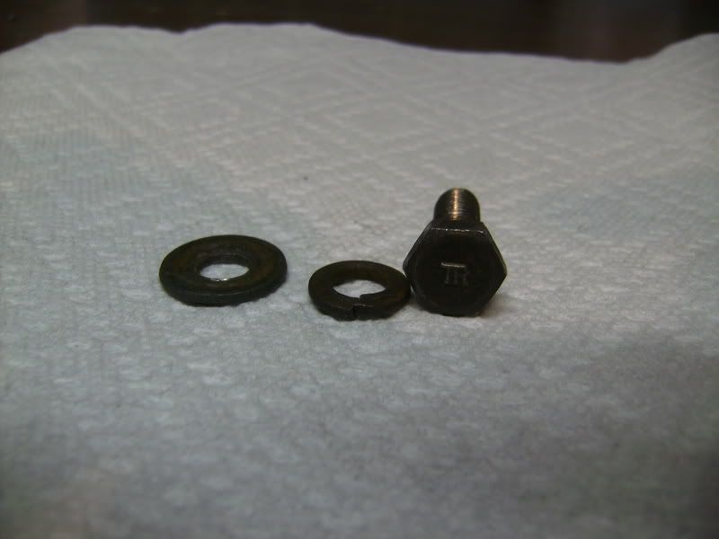

    Since John Pirkle has my alternator, this is from an April 63 car.

          Here ya go.
          Washer, OD - .76 Hole D. - .30 Thickness - .06
          L/W, OD - .51 Hole D. - .32 Thickness - .09
          Like you, this is what is there.

              Harry, What's with the blacked plating on the hardware.??? Should be zincad I believe. JD
              • Harry S.
                • July 31, 2002
                • 5344
                #22
                Re: Alternator adjustment bolt
                John, may have been plated in 1963, but untouched since then best I can tell.
