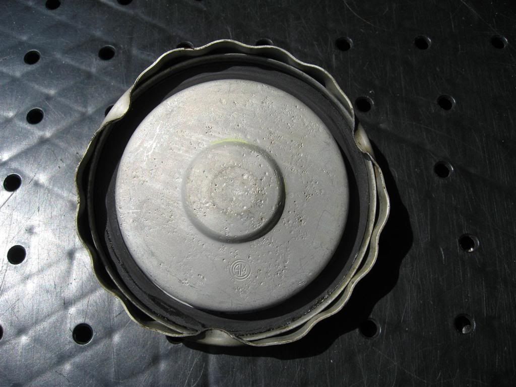

                • Gerard Q.
                  • February 1, 2000
                  • 284
                  Re: 1970 versus 1971 gas caps
                  Just for reference the original gas cap from my May built 71.

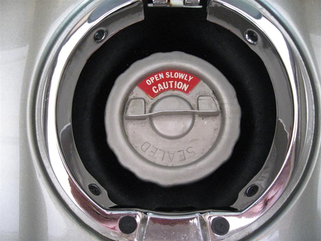

                        • Tom H.
                          • December 1, 1993
                          • 3440
                          Hey guys. Got in on this one a little late. For what it's worth, here's the original cap on my January 71 coupe.
                          Tom Hendricks
