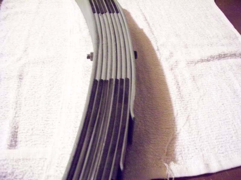

    I was wondering if the shown rear spring could be original to the car. I think not because a lot of stuff in the rear suspension of the car seems to be replaced with service parts or replacements of other, later model year cars.
    Please let me know your thoughts after examining this picture.

    Rob, I do not believe that is a 63 spring. It was either 9 leaves (standard suspension) or 7 leaves (HD suspension). From the picture I count 8 leaves.
    Some 63 spring characteristics, there are plastic lines between all the leaves, except the top two. The ends of all the leaves curve up. The overall shape of each leaf is to curve down.

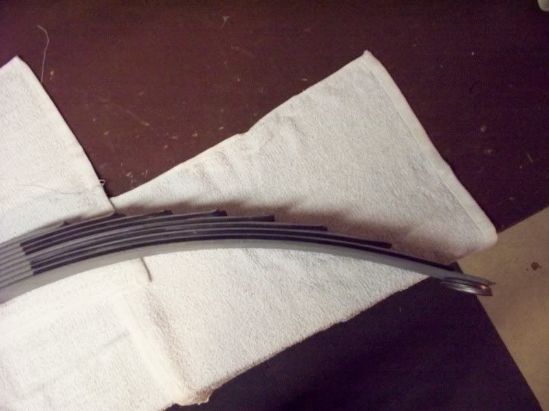

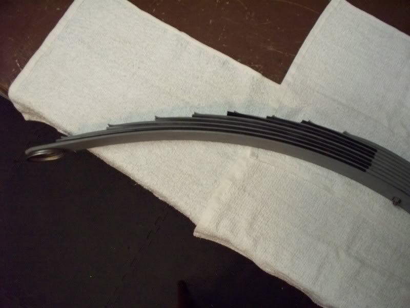

    Later today I'll post a picture of a 63 spring I just restored.

      63 Spring, 9 leaf.

        Nice job Harry!
