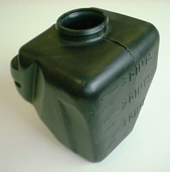

    68-69 Judging Guide says that graduations on the washer bottle should be "Full, half, etc".
    Is this washer bottle incorrect?

    I see that there are 2 reproductions available. One from the U.S., and one from China. Perhaps you can make a call to see if the 'other' one, from what you have, has the correct markings.
      Michael-----
      Here's an absolutely, positively known original from a 1969. I came into its possession (with the rest of the car) 39 years ago today.
