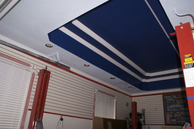

        Several of the guys have modified the garage rafters forming a trey type recess to accomodate the necessary added heighth reguirement.
