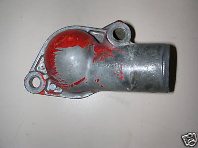

                  The photo didn't get attached to my last post, but here it is since I can't seem to add it to that post.
                          That's the one that I have. Thanks, now I've got one less thing to replace before the car is judged this Sunday!
