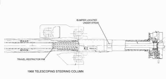

            There is a rectangular part called a bumper that is strapped to the outside of the steering column. It is on top of the column jacket just forward (toward the steering wheel) of the big mounting bracket. The bumper sits in a cutout in the outer jacket. There is a crimped strap that holds the bumper in place in the cutout.
            The bumper sticks through the outer jacket and the inner telescoping tube has a long depression that the bumper slides in. The ends of the depression restrict the telescoping travel of the inner tube. The bumper must be missing from your steering column.
            There should also be a pin that is pressed into the upper steering shaft that should also prevent the solid upper shaft from telescoping completely out of the tubular lower shaft. This pin must be missing as well!
            Bubba has been working on your steering column. It certainly is not safe in its current condition even though you most likely have to pull the steering wheel and steering shaft a considerable distance to disengage the steering.
            Now the bad news. I don't know where you will find a replacement bumper. I would think that you can cobble a replacement pin.
            Jim

              You're correct in that I do have to pull the wheel and shaft a considerable distance to remove it; more than I would ever do under driving conditions. It's just unnerving that I can do it so easily but only after I unlock the ring for telescoping.
              The service manual exploded view shows two bumpers, plus one key and strap but doesn't say anything about the restrictor pin (unless I totally missed that info and I just went through the section again looking just for that). Your sketch gives me a better understanding of how it should be - thanks for posting it. From what document did it originate?

                The posted drawing is a portion of the actual Saginaw steering column assembly drawing. I am sure that the pin is a redundant, fail-safe mechanism.
                Jim
