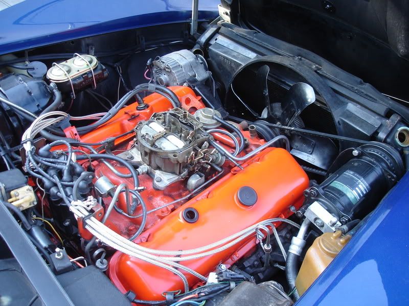

    Mine has the solid band clamp with flat blade screw on the hose going to the radiator and no clamp on the overflow hose (yes, I know I have the wrong fan and I'm missing my smog)

      Here's what looking at engine compartment pictures of 73's on sale on e-bay has turned up: the majority have the solid band clamp with flat blade screw. While most of these cars aren't exactly Top Flight examples, this style clamp is definitely the most common. Am I just seeing car after car where owners replaced the original spring clamps? Or were these what the cars left St. Louis with?
      William-----
      I don't think they've been replaced. For one thing, the band-style clamp with side screw of the configuration pictured is generally a PRODUCTION-style clamp. I consider it unlikely that such a clamp would have been used in a field replacement situation. For field replacement, it's FAR, FAR more likely that a stainless steel, worm screw type clamp would have been used. So, I have no real doubt that clamps such as the ones seen on your car are original.
      However, these clamps are are certainly not the ones that GM specified to be used as shown in the AIM and as also seen on other apparently known-original cars. Generally, I have noted the band-style, spring clamps for the coolant reservoir hose, but I do not doubt that others were used. Here's what I think happened:
      The band-style spring clamps have a very narrow range of hose OD size that they are designed to effectively work with. For instance, I believe that the reason for the change from the 3786276 to the 3829058 probably occurred because there was a slight change in the OD of the hose at some point. Keep in mind that the sort of hose that was used for the coolant reservoir was a commodity-type item---it was supplied by different suppliers and there may have been slight or,perhaps, not-so-slight differences in the OD of the tubing used by the assembly plants. When tubing OD changed, there was likely a need to change clamps since, as I mentioned, the band-style spring clamps work within a very narrow range of hose OD size.
      The 3786276 and 3829058 would work for 2 slightly different hose OD sizes. However, what if another slightly different yet hose OD size began to be supplied? GM may not have had another spring-style clamp available which would work with that size hose. However, the band style, side screw clamp would have a wider range of hose sizes that it would work with. So, perhaps it was decided, at some point, to just go ahead and use this style clamp which would work with whatever slightly different OD size hoses were supplied. Or, it may be that the band style, screw clamp was used only when the factory was receiving and installing the "oddball" size hose OD. The one thing that surprises me, though, is the fact that the side screw clamps were apparently used with the cap end of the reservoir hose. That's because the nipple on this end is PLASTIC. The side screw clamps can cause breakage of the plastic and I don't know of another application in which a side screw style clamp was used with a plastic nipple.
      I believe the band style , side screw clamps used were GM #9420534. This was a PRODUCTION-only clamp, not available from GM in SERVICE and not typically available in the aftermarket.
