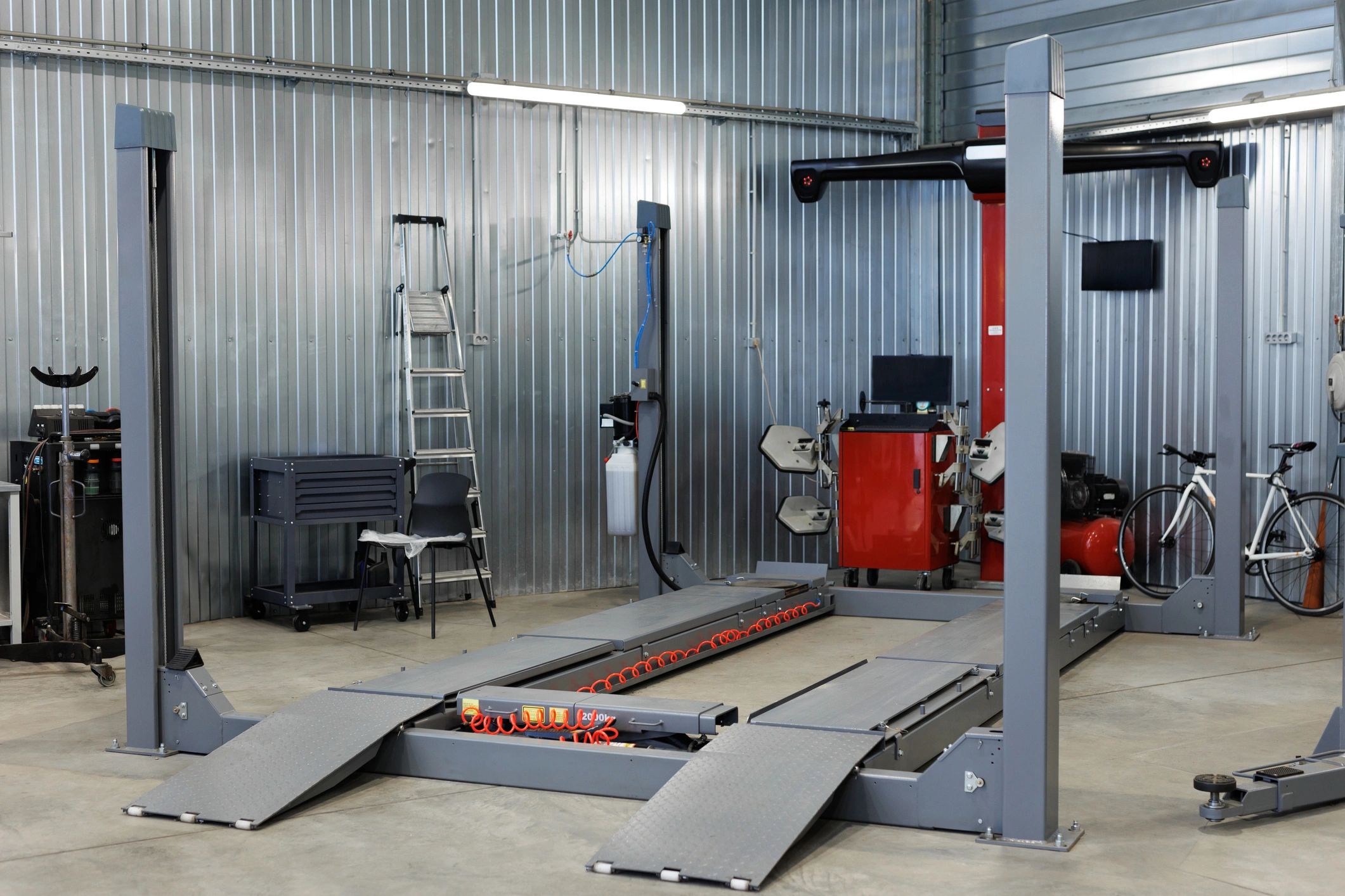

                Here's another option from BendPak, if your aim is not to store cars, but rather be able to work underneath them. It is a free-standing scissor lift that will put the car in the about 4.5 feet. It is not the most convenient lift in the world, as the scissor internals are under the car, but one can still get to everything fairly easily. It has a dolly so that it can move around the garage. There are still those of us whose garages do not have enough ceiling height to install a 4 post lift or a 4 arm swing out lift, and this is a perfect option for us.

                        Just like everything in life, there are many choices and many opinions. For my situation, I have a 4 post lift (extended height 12' ceilings) and absolutely love it. I have a mid engine car in addition to my Vette, and to do service on it, the lift does a lot of up and down, and knowing that the car is firmly planted on the rails of the 4 post, is quite a reassurance to me, especially if I need to reef and pry on fasteners. I have two sliding trays that I use a bottle jack and jackstands to lift a tire off from the lift as required. I have long drive on ramps, and have no problem with putting a car up on the deck of the lift.
