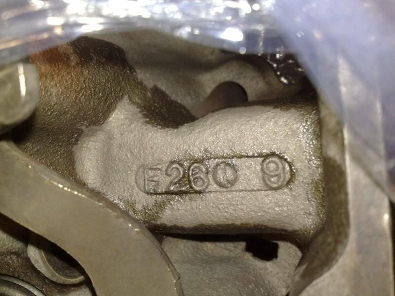

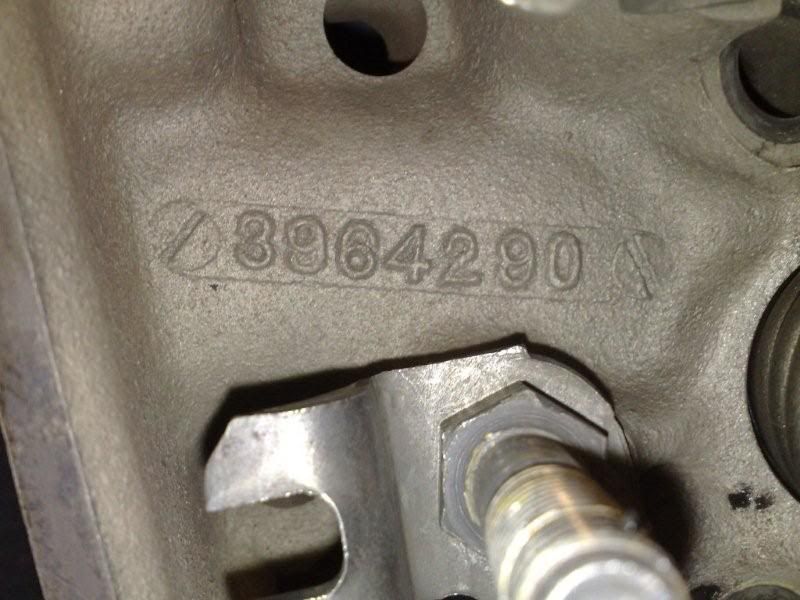

                        A friend of mine has a fairly original L36, mid July car. Below pictures of the headers of his car - he has the 290 heads with a casting F 26 9 (June 26 1969 I guess)
                        Erik
