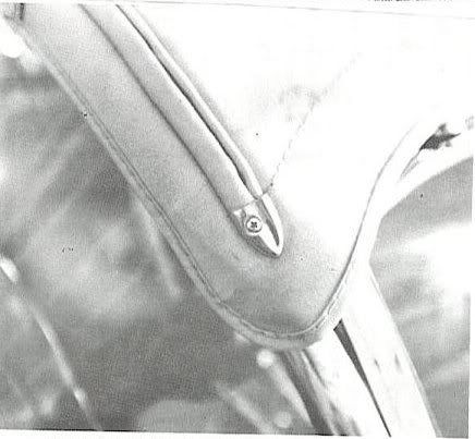

    Which way is the front strip? , with the stainless ends supposed to face, mine face so the weather from the front, rain if ever driven could not get in and rot the tac strips, as per Al Knock video which makes sence to me? Thanks Brad

    And Original 55 S/S end cap, same used on 55-57 T-bird's
