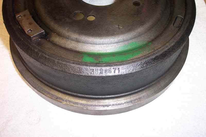

                  Sam, it may be hard to see on your drum but as RJ asked, do you have an X or another letter stamped into your drum?.....Harry

                    Hi Harry, there is an X stamped into both fronts same spots as your picture. On the rears, nothing in that area but along the rim there are WD after the cast # and a W-7X on the other rear.

                      I think the X is for Matalic and the F is for non-Metalic brakes.
