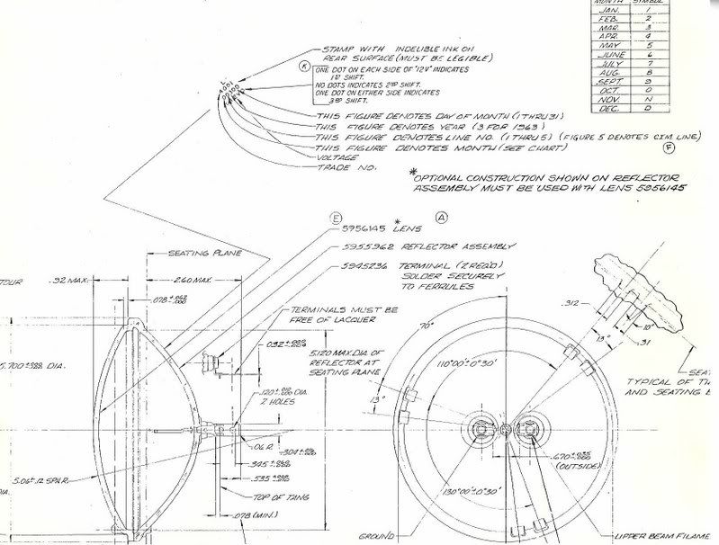

            This may help identify what you have, but I'd go with Stu's suggestion.
