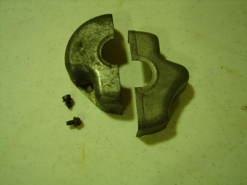

        Are you refering to the RFI Shielding? Here is a picture of a set but I couldn't tell you what years they were used.

          Use of the RFI shield began 1970 production around s/n 12,000 or there a bouts and continued into 1974 -- Or so I think – anyway it went until the HEI came into production. Definitely not applicable to 1957.
          BTW-- nice pic Kevin.

              Excellent memory. The 1972 Chevrolet Corvette Parts Book I have shows this shield is applicable to 1970-71 with 350 cid and 454 cid engines, except SHP. Part #1846216. The parts book ends sometime in 1972, so anything later than that would not show up.
              Definitely not 1950's.
              Larry

                Kevin's picture is it! I was told by a parts vendor that it was used on '57's but I never saw one on a '57. Now I know why.
                Thanks to all of you!
