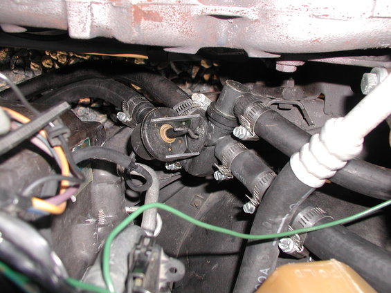

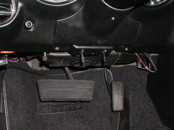

                    I just installed a second vacuum switch and a bypass valve in my '73. May not be 'correct' but it looks original, at least to me.
