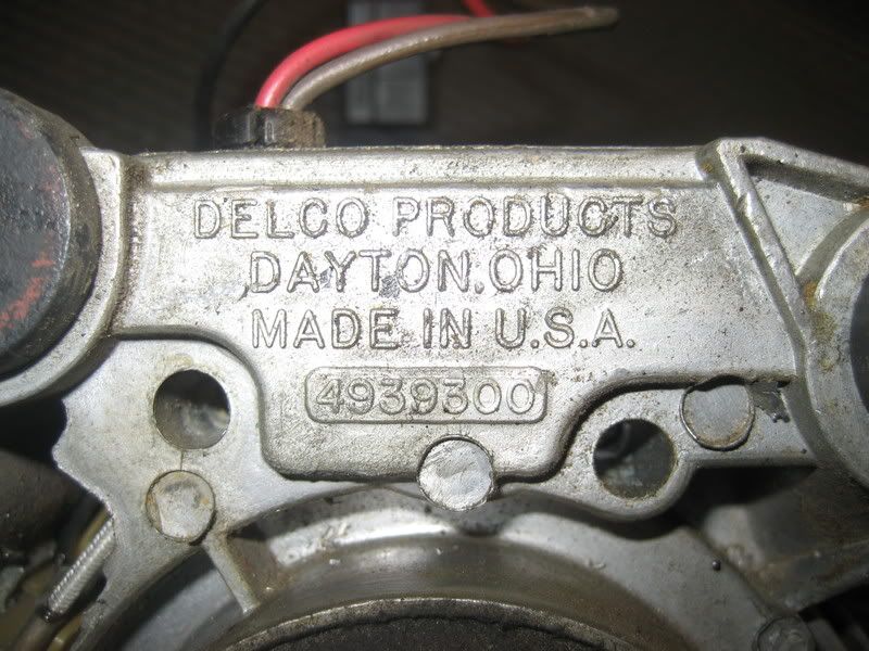

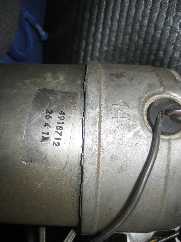

        Steve - the 4939300 part no can also be found on service replacement 68 pumps - pics of my pump
        Erik

          Erik-----
          In this case, the 4939300 number is a casting number for the cast housing component of the pump assembly. It might also be the part number for the housing but I can't confirm that because the housing was never available as a separate part, only as part of the complete motor assembly.
