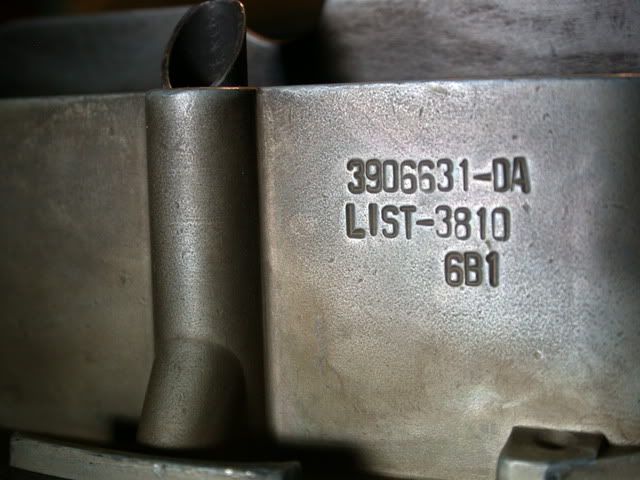

    Hello Everyone,
    This is a photo of the carb from a '67 L-79 Coupe I recently purchased. Is this the correct carb? At first I thought it was dated 681, but it appears to be a "B" and not an "8" and now I'm confused.

    Re: Help to ID this carb
    Dec. 1, 1966
      Per the Judging Guide, "B" is december, so it would have been built in December of 1966, first week
        That what I mean, First week of Dec.
          The body build is E09 (Dec. 9th) and production date was Dec. 12th according to the documentation from GM Canada.
            Kurt,
            That carb is probably a perfect match for your car. The carb was put on in St. Louis, and is a week before your final assembly date. You couldn't get closer.
            On my 67, just about everything is dated within 3 weeks, castings to assembly date.
