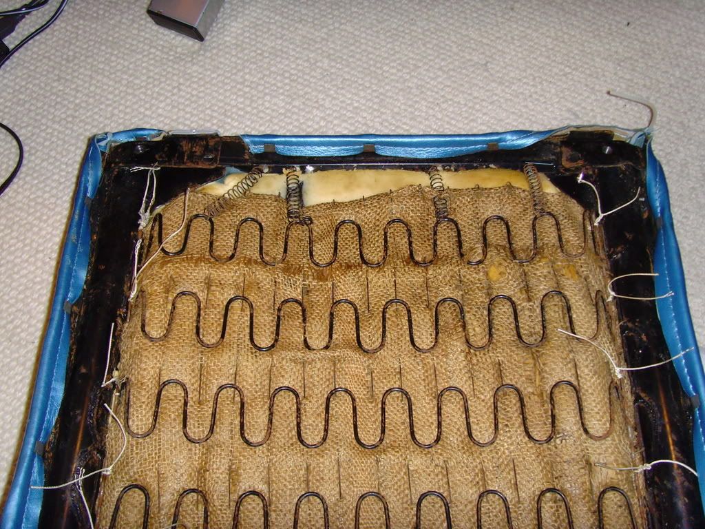

        Don, here is another pic. Mine had been rebuilt some time back - but the springs appeared original.
        You may find that the "clips" are hard to get through and hook when you recover the bottoms. I had to use nylon thread in some places (like you see in the attached before I recovered mineats). Some people feel that thread is better than the clips.
