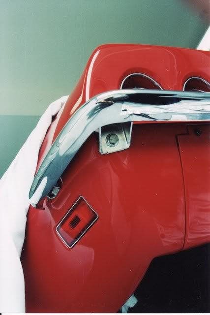

      Hi Mark,
      I had Mille Miglia Red acrylic lacquer sprayed on my 71, three years ago. I think very few people think it's a good choice because of the many other great paint systems that are available. I'm pleased with it because it looks like I remember it looked when it was new (only a little better). I had a very hard time deciding to use lacquer but am very happy so far.
