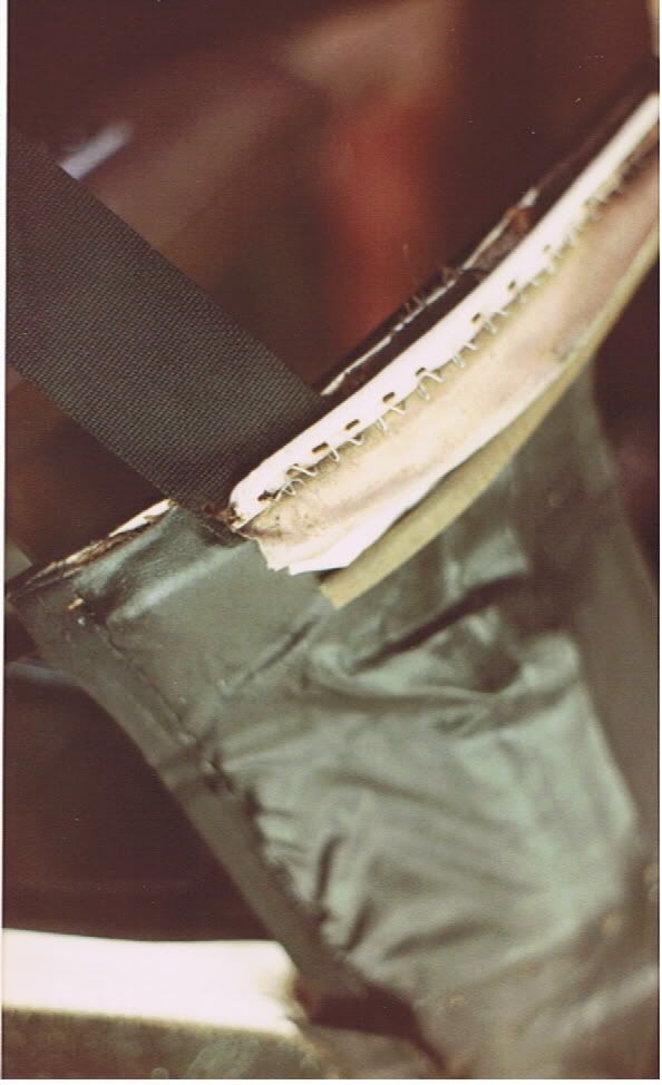

        The original staples were about 3/16 or so across the top, and they were fairly thin. I could dig up a picture somewhere, but as stated, they are not visible when assembled, even with the top back.

          If you could send a picture I would appreciate it.

            This is not a midyear, but it is the same staple.

                    I've read in a 1992 Restorer Article, that the OEM staple was 1/8" crown by 5/16" length.
                    However, when I did my C2 top, I used SS No. 4 (3/8" crown) by 3/8" length with a manual stapler for the top to tack strips, and galvanized 1/4" crown by 1/2" with an air stapler for going through multiple layers of material such as the wireon, front windlace, and rear straps to tack strip.
