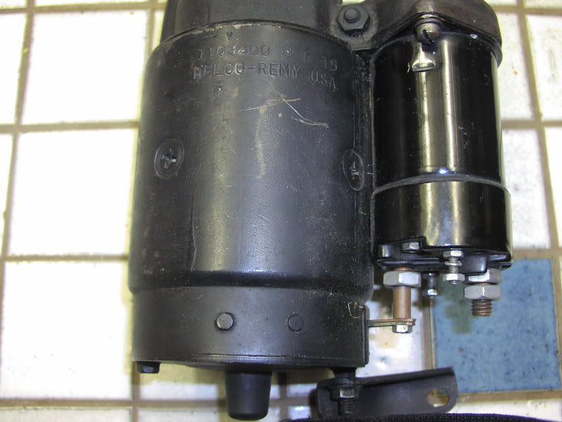

      Mike --- here's a service 1114356, and it's what I'd call a semi-gloss (rather than Joe's description of semi-flat [glass half full ? empty ?]).
      Also, my GM P&A30 parts catalogs for 1969 do indicate the "356" as the service solenoid for the "8400" starter.

        Wayne,
        Judging by your picture this looks like an original starter & solenoid with the correct colors. If I can see a reflection I call it gloss. I guess some call it semi-gloss and yet others call it semi-flat.
